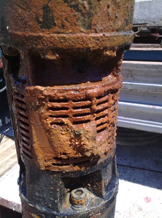

Major problems can arise in the collection field of an open loop GSHP system with bacterial growth and iron oxide debris or sludge. Iron is one of the most common elements found in nature, accounts for at least 5% of the earth's crust and most groundwater contains a concentration of dissolved iron. Whether caused by bacterial activity, drilling, or through chemical reactions, these residues will eventually affect nearly everyone who sources water from aquifers.
GSHP systems can grind to a halt within a few months if contaminated with bacterial growth or iron oxide. Bacteria and associated residues can build up inside the heat exchanger, clog both the abstraction and recharge wells and increase the friction losses in the flow section of the system. This reduces output, wastes energy, increases operating costs and can compromise the original reason for opting for geothermal energy.

Iron Oxide Contamination
Geoquip's maintenance programme for GSHP systems includes a downhole survey using a portable Laval video inspection system, an analysis of the survey and the available water quality data, a purpose built rehabilitation rig and BoreSaver. BoreSaver's low environmental impact makes it an attractive solution for individuals and organisations intent on maintaining their responsibilities to the wider public.
